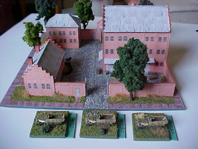

Pic of a factory complex I scratch built several months ago. Paper on styrene. GHQ halftracks .
Base measures 6" x 6".

Paper on styrene?????!!!!!!!
Damn, but don't that look coooooool!!!
I've been experimenting w/paper houses using the paint program w/windows because of what I've seem here and I think they look NOTHING like that.
Outstanding
